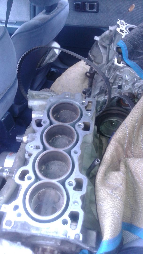

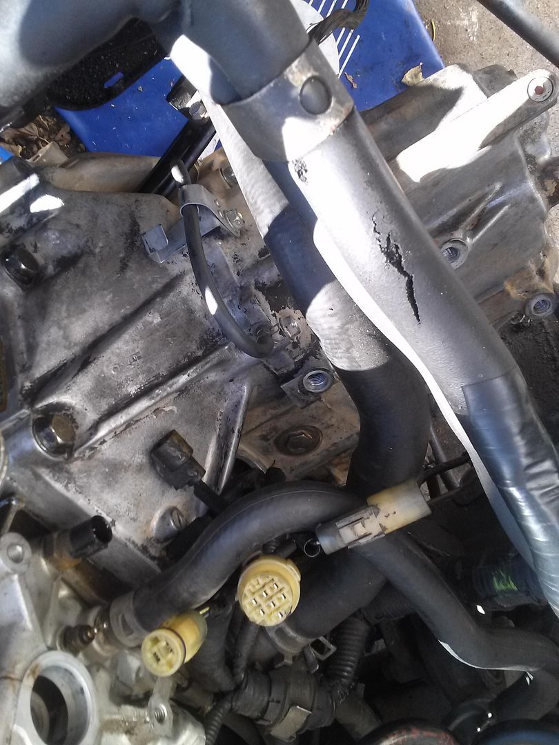

Bought a B16 recently too in hopes to freshen it up and flip it for a decent profit. Once it came apart it looks like it's goin to be an investment... :/
Crank is in good shape. At that much was in good condition.
Rods are in good shape as well. It's the pistons that weren't good. Ring lands on three and four were broken. This is the result of boosting on stock cast pistons. SMH.
Luckily the didn't gouge the cylinder walls, but the block will have to be opened +.020" anyway to get rid of all the wear. Frustrating part is that I have a set of GSR pistons +.030" but those would significantly lower the compression. :p So it's like I said, it would become an investment.

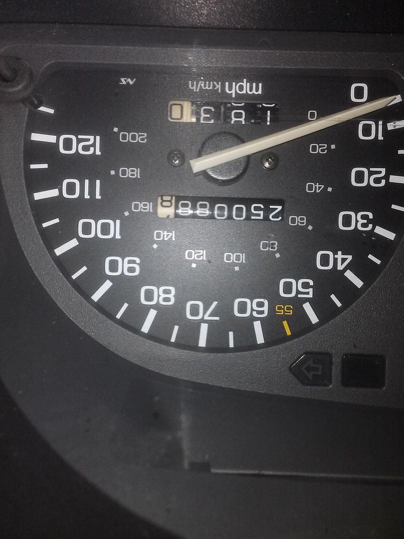

Lots of things have been going on. Transmission took a crap, finally finished my performance head, picked up some GodSpeed rear LCA's (pics later), and I busted the 1/4 of-a-million-mile marker on the odometer! Lol!

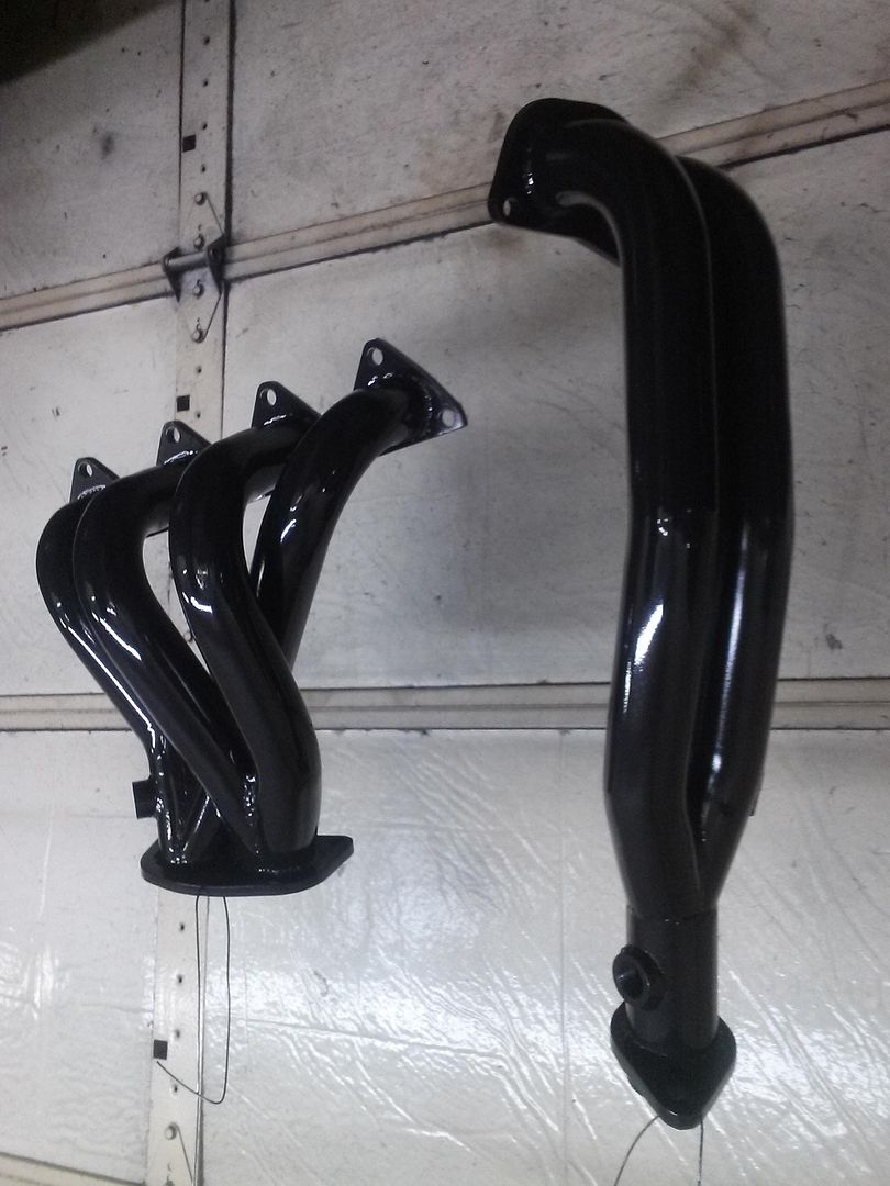

Also, had a friend give me a SOHC 4-2-1header and figured, since I'll be replacing the head soon... might as well fix it up too! So I cerama-coated it black. Was gonna be white, but that stuff is now rock solid because it never got used.

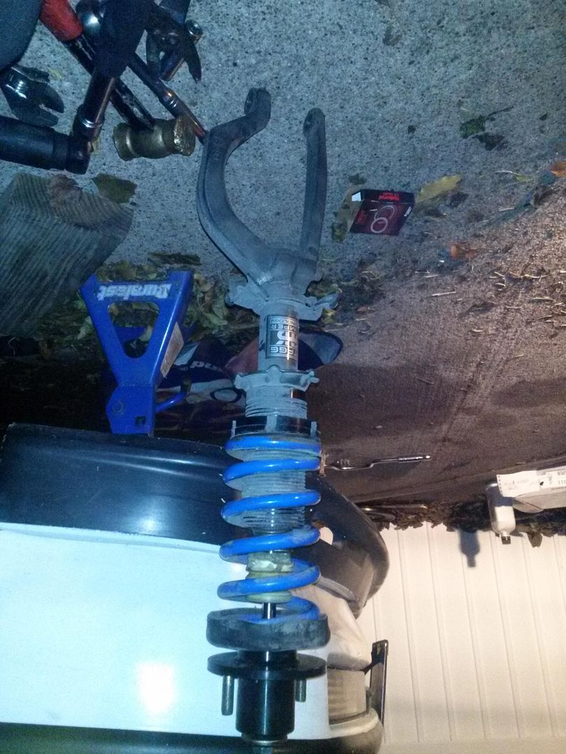

As for anyone curious about what suspension set up I run... The springs are unknown to me. I've been told they are Ground Controls, but I'm doubtful. They came on the car when I got it. I have a full length shock and ebay aluminum extended top hats. this setup works great too!
This!

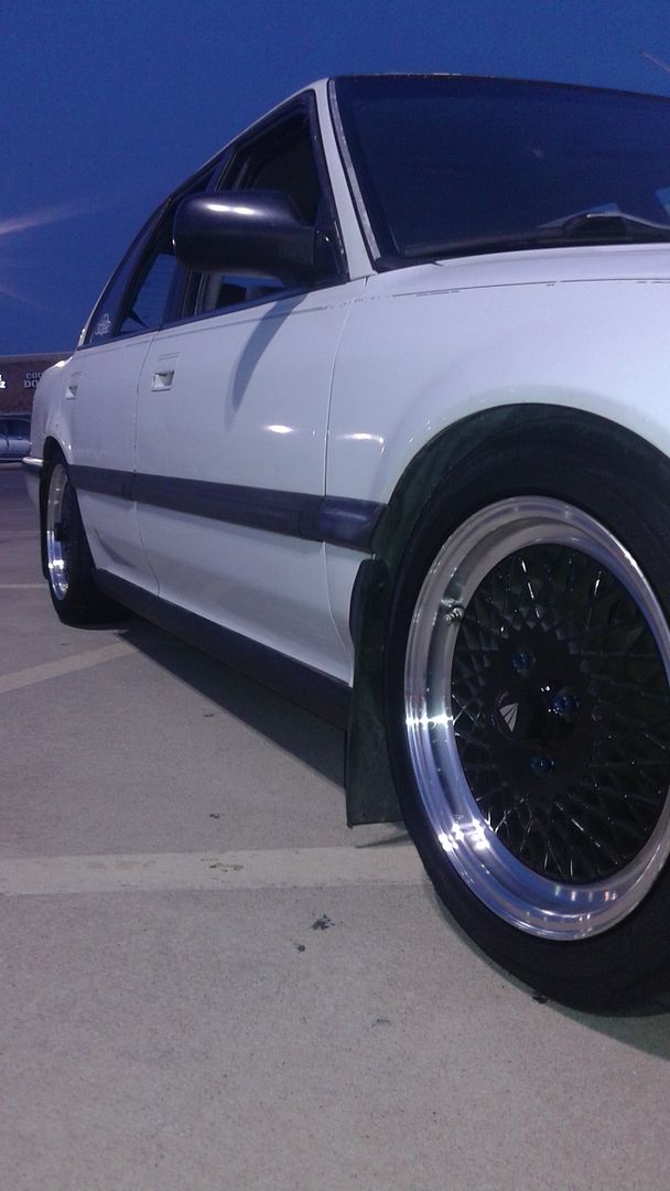

Oh! And I finally got rid of the Fugen's and traded them for a set of Avid1 wheels that look like Slips/Spoons/Regamasters. Cannot WAIT to get the powder coated white!!

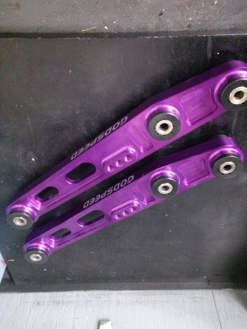

Here's the GodSpeed LCA's!
One installed... Hate putting new parts on a dirty car...
Here's both even though the incorrectly installed dumbass muffler is in the friggin way! I hope to fix this soon. -_-

So shortly after doing the rear control arms, the sedan crept over a 1/4 of a million miles.
I know not much of a accomplishment for some, but it has never happened to me before. also had to start prepping for a clutch swap. Mine was starting to slip. So I decided to lighten a flywheel... :shock:

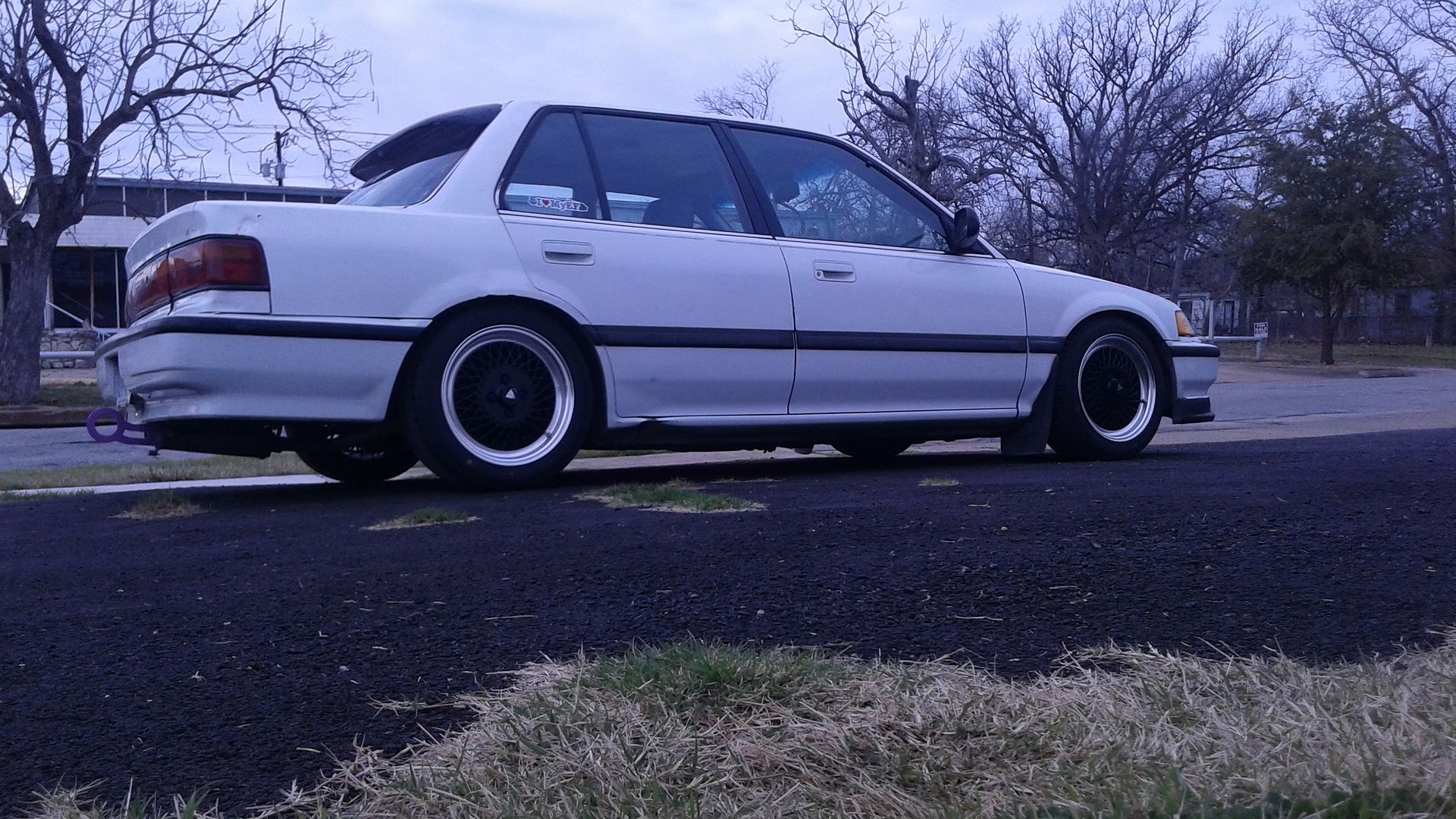

Traded off the white Fugen's for some Avid1 wheels

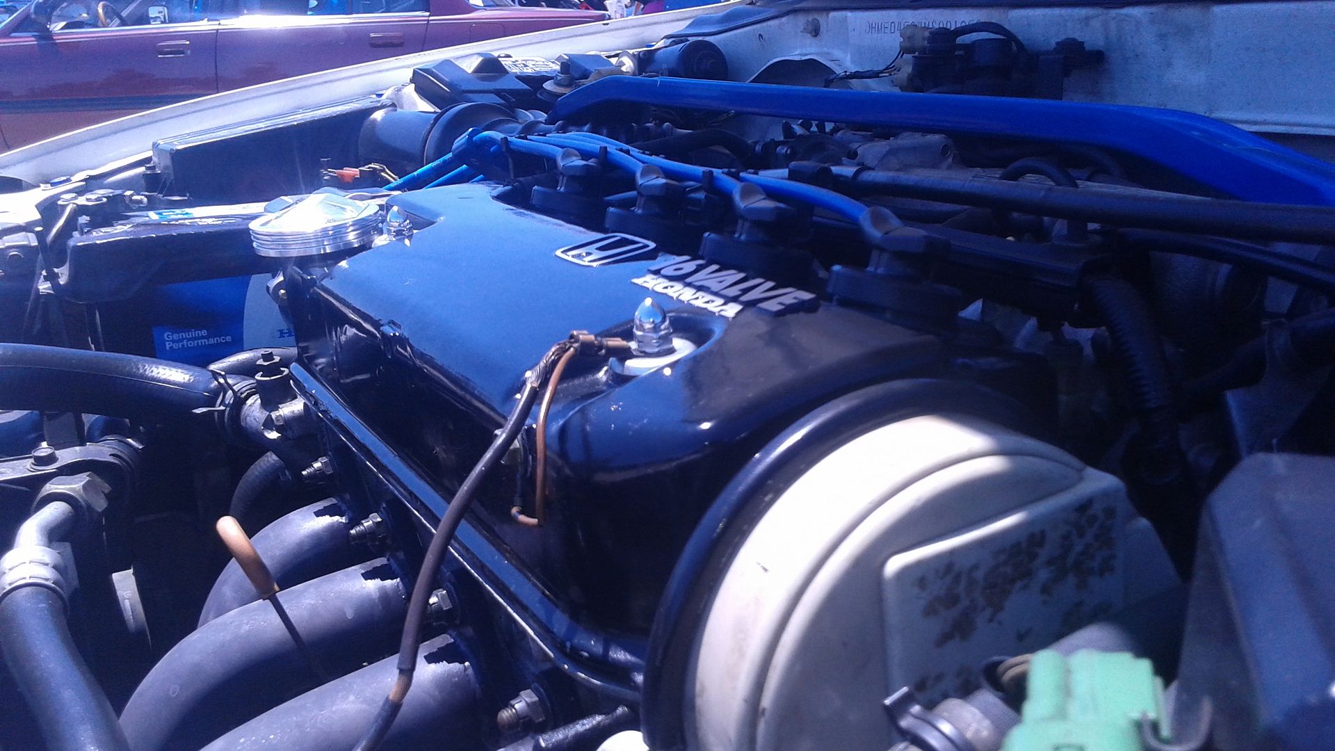

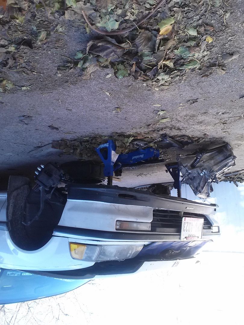

I finally broke down, and while the weather gave us a little break, I swapped the head on my single-cam to my polished and ported head!
Back together!
She runs great too!

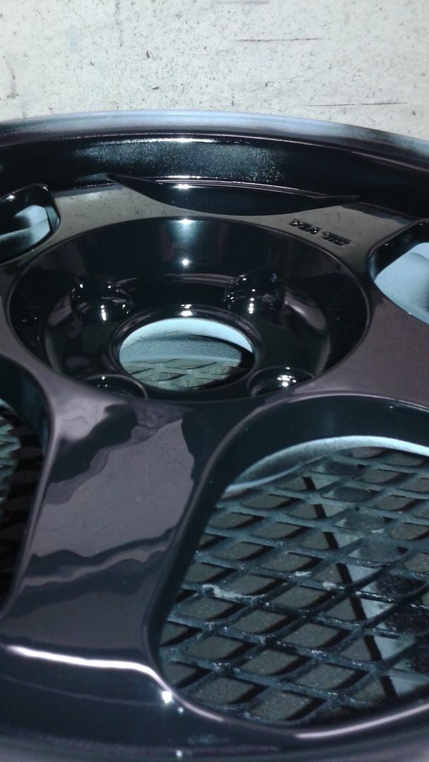

I borrowed a set of steelies from a friend so I could start repainting the gold wheels... Gold is not my color when it comes to wheels...
The plan was to do the centers in gloss black and then the lips in white.

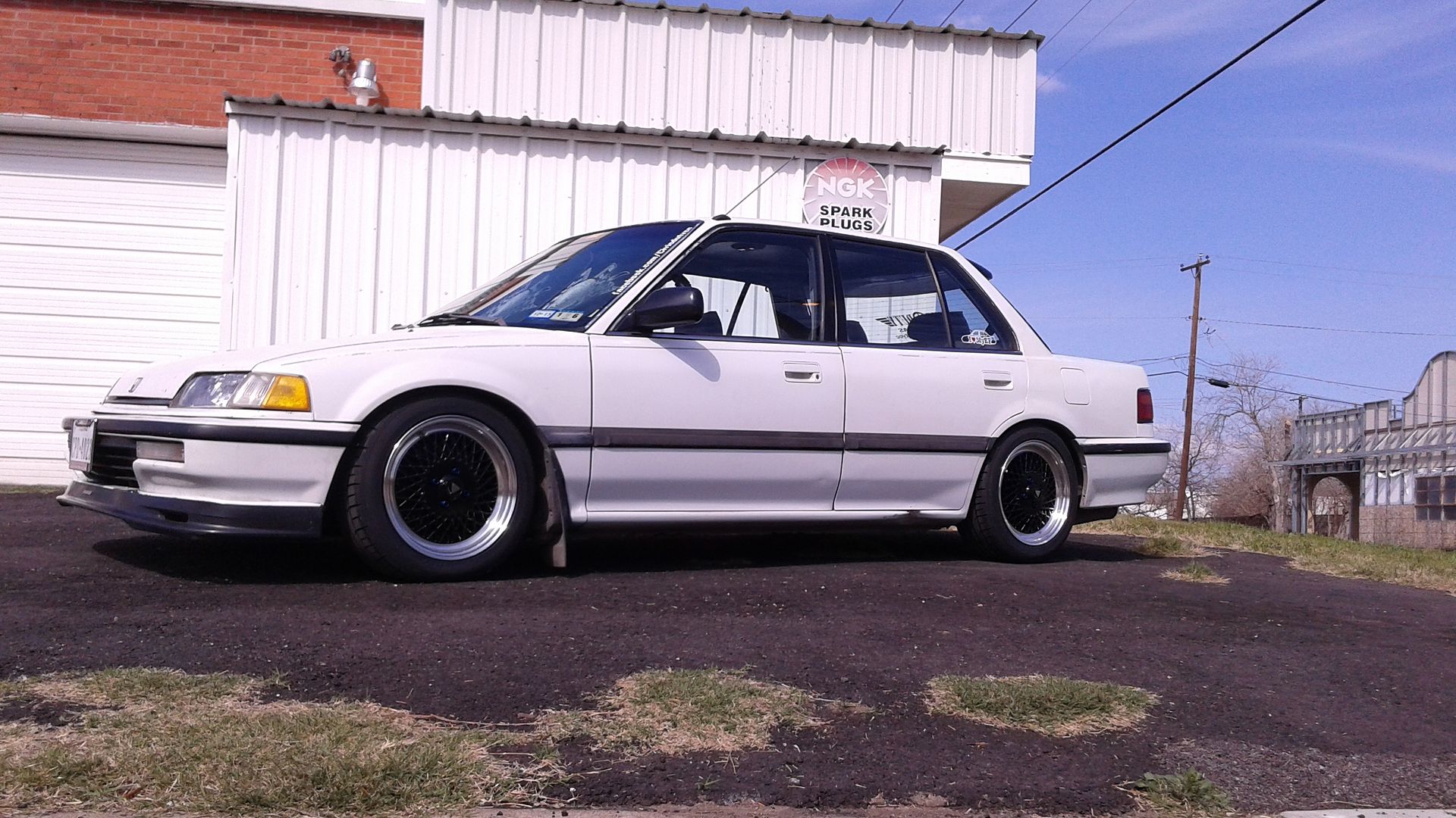

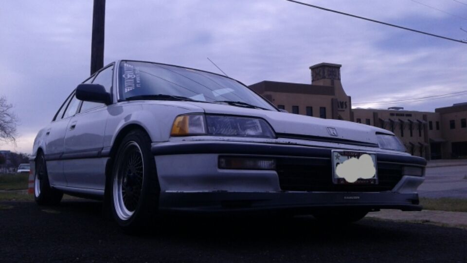

When tax returns finally came in and I hustled my ass down bought a brand spanking new set of Enkei 92's!!

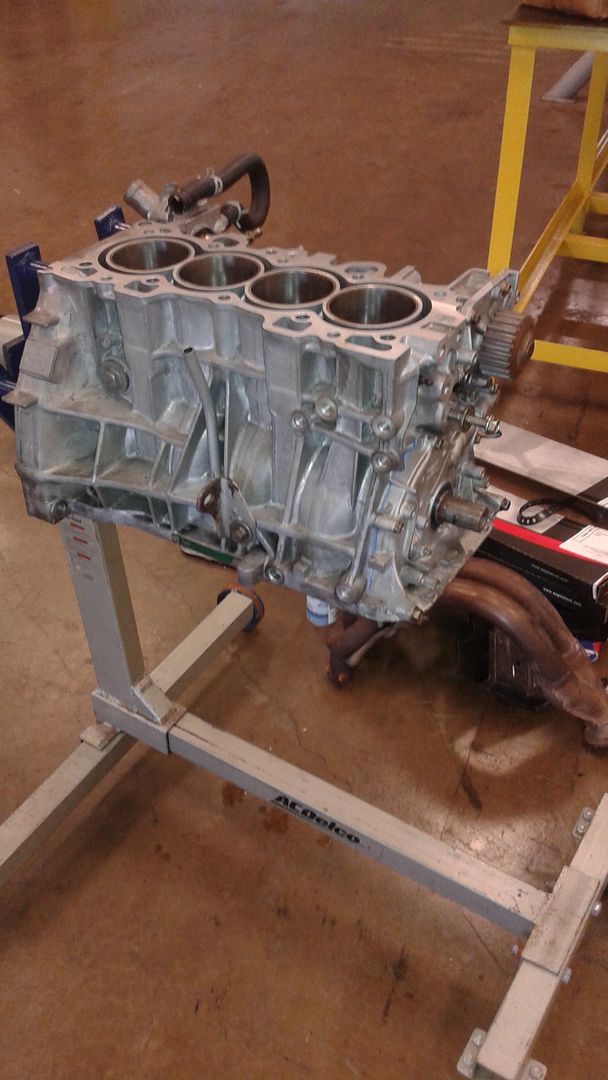

Also had a lucrative offer on some B-series blocks... What might I be doing with these???

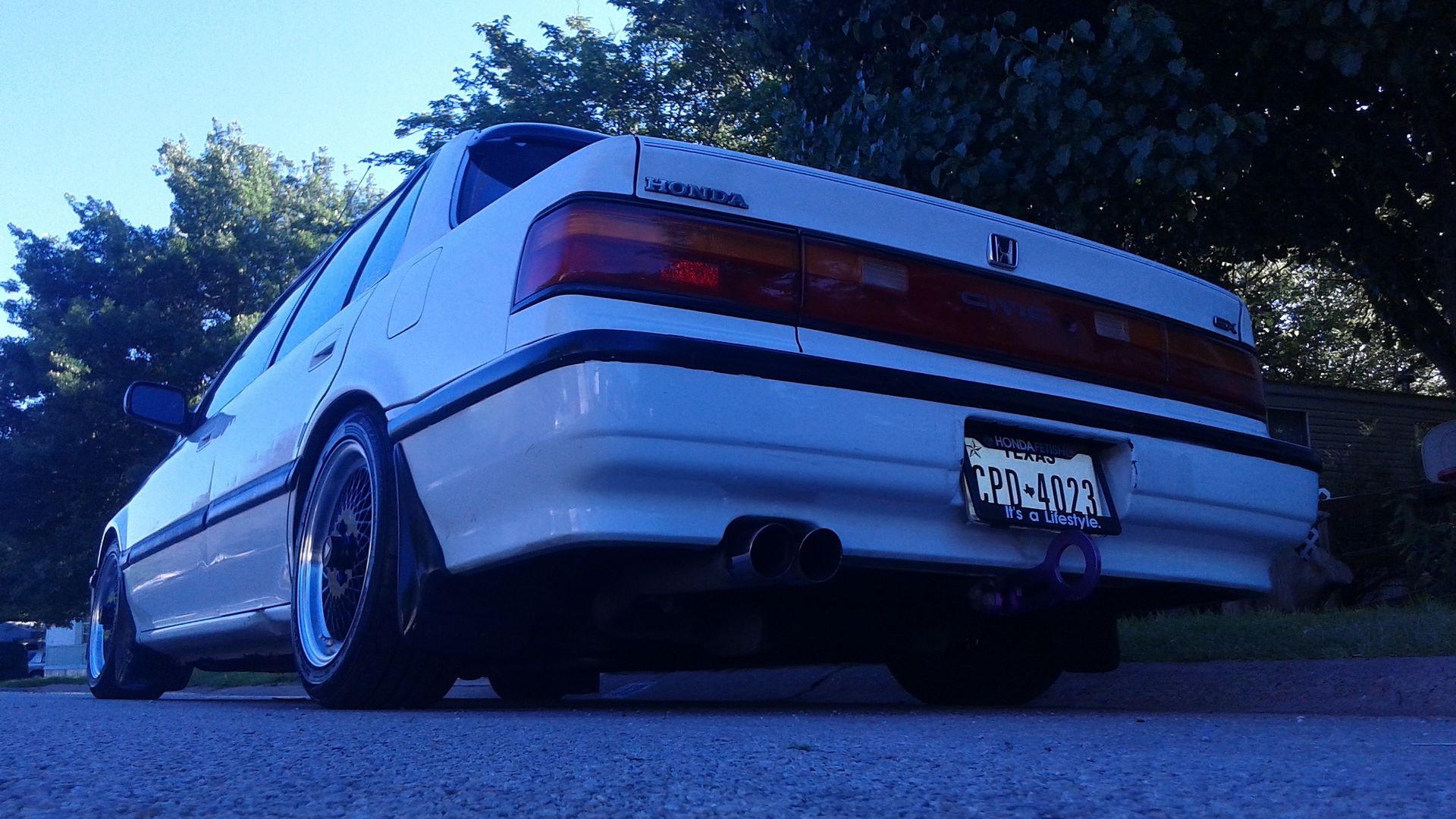

Then my exhaust finally took a crap...

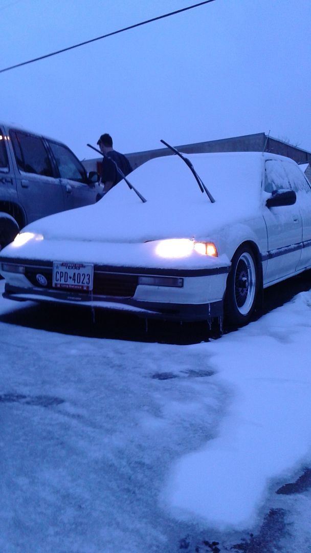

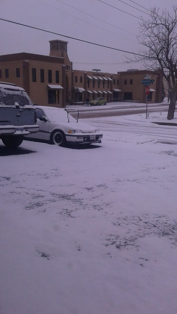

It got cold back in January and we actually got to see some snow this year! Real snow, not that sleety shit!
Shortly after these pics were taken, things started changing in my life. Pretty serious things. While I was getting my entirely overpriced exhaust attached to my car, the owner of the machine shop I worked at called me and commenced to cuss me up one side and down the other, simply because I was not at the shop working. I tried to explain to him multiple times that the cat clogged and I needed to resolve the issue in order to drive the car. He wasn't hearing any of it. He didn't care. Well needless to say I was not about to suffer that disrespect. I left the exhaust shop and headed straight to another machine shop and began negotiations on getting a job at their location. Another month went by before my boss and I had one more altercation and I quit and went to the other shop the next day. It's been a little rocky adjusting to the gap in pay but my wife and I are starting to pull through it! Before I left AMS I got all the machining done on the head for the B16 and everything cleaned up and ready for the block to be honed out. I had to wait a little while before I brought it up to my new boss, but he was very enthusiastic to have me bring my block down and start assembling the motor.

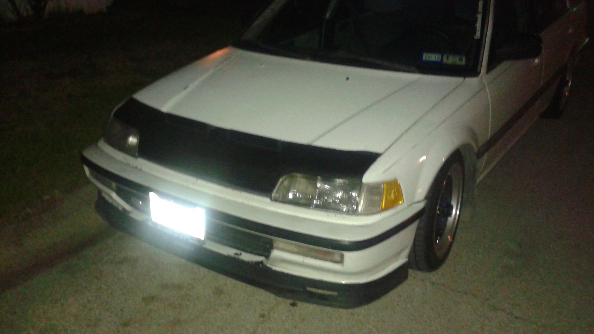

Picked up hood bra for $40 as well!

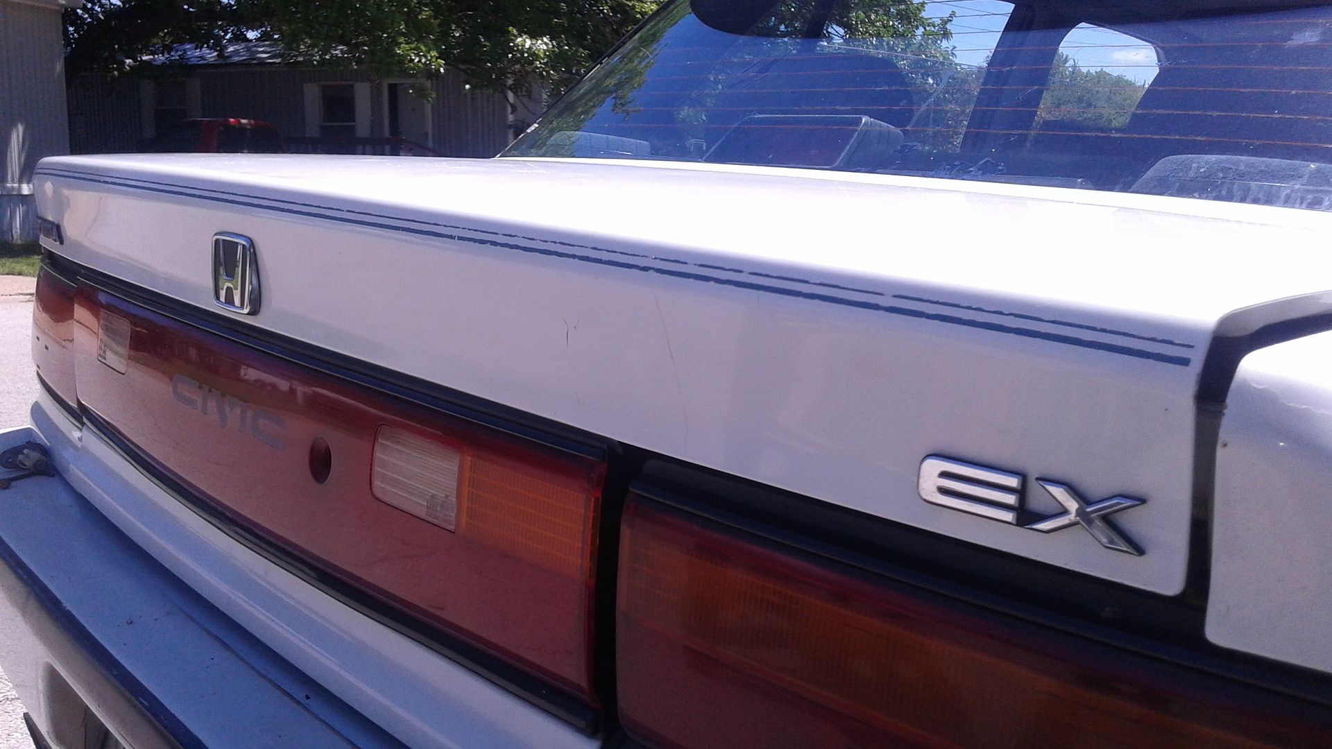

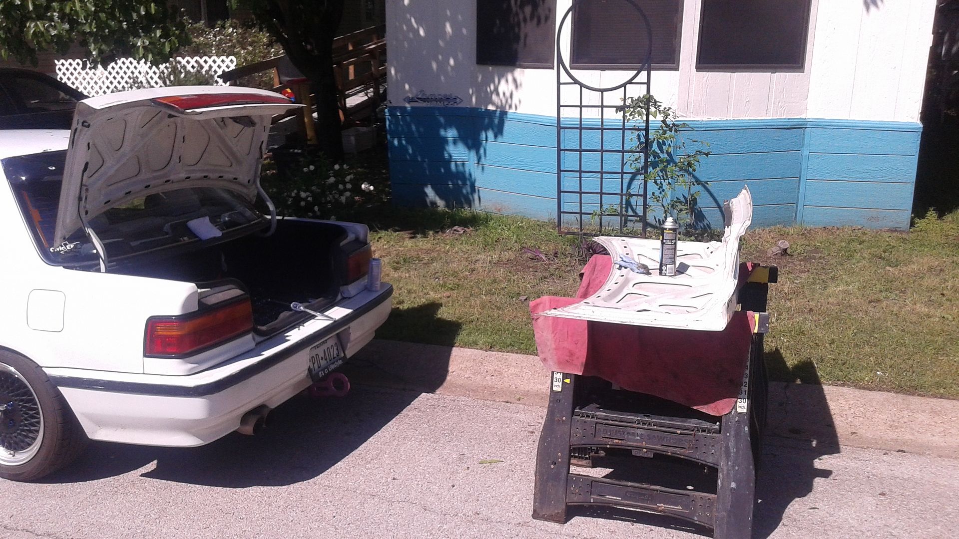

Finally swapped out the trunk. The clear is all still on the new one! LOL!
Put my EX and Honda badges back on as well!

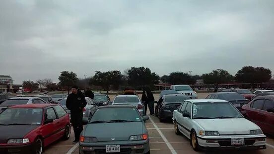

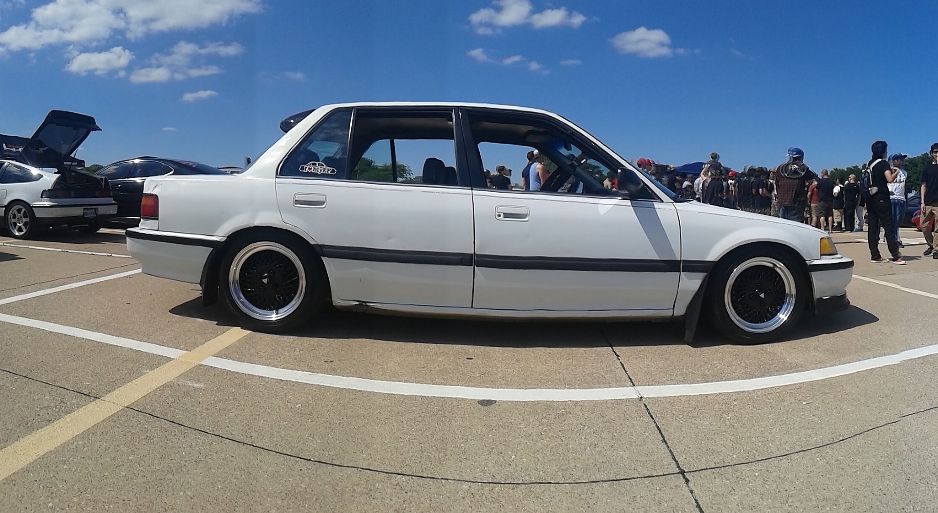

Had to give her a wash before the Honda Fetish meet!

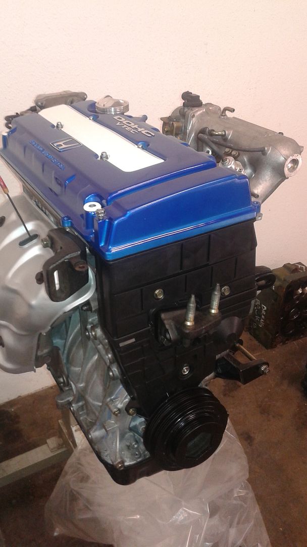

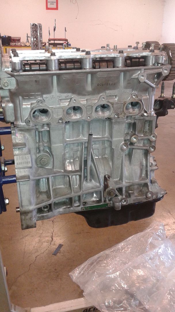

Duh-duh-DUUUUUHHHHHHHH!!!! The B16 starts to come together

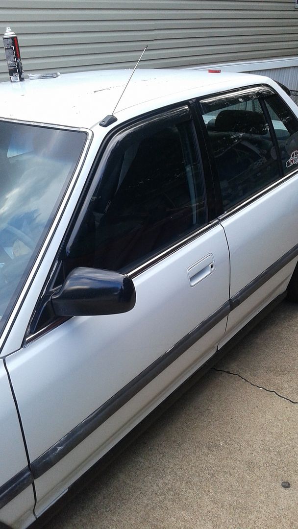

A little bit of a update for you guys! Picked up some Wagon skirts from a friend not too long ago. Threw them on to hide those hideous dents in the rockers where someone dropped the car off a lift.. The results were much better than I expected!
Dah-tah! No more dents (that you can see anyways)!

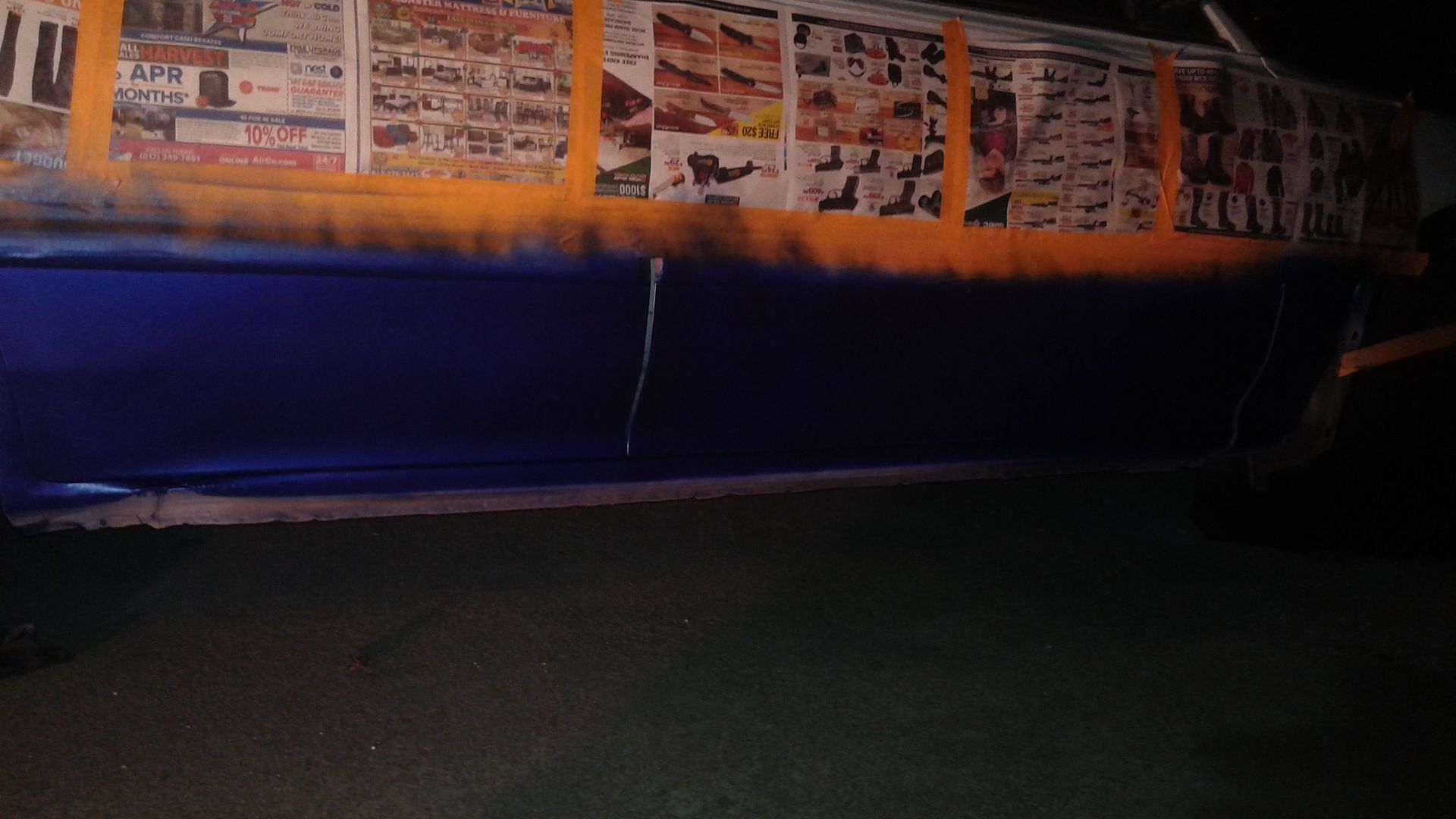

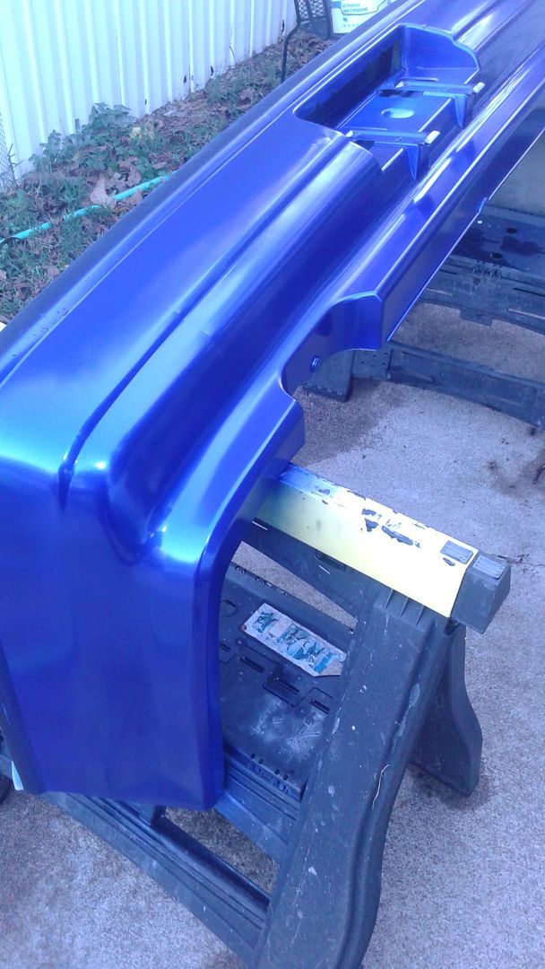

So the B16 has been put on the back burner for the moment. Plans of buying a house have come into the equation for my family and I. But in the meantime, I've been really getting proactive about making the sedan more presentable for the HF Nation meet in October! Since I don't think a lot of you follow me on Facebook, I'll give you some sneek peaks here! (feel privileged)

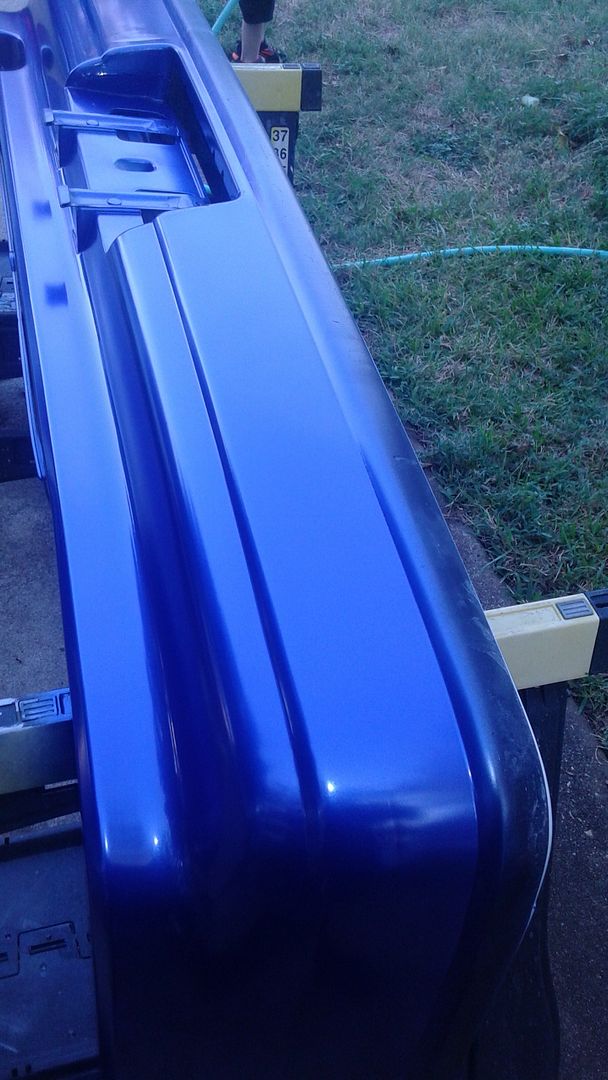

Electron Blue Pearl (EBP)
It's dark in these next pics, but that's ok. I want to keep a little bit of mystery about this until it's completely finished
A friend parted with a set of rainguards that didn't exactly fit right on his car. I took em to work and modified them. Made them more presentable.
