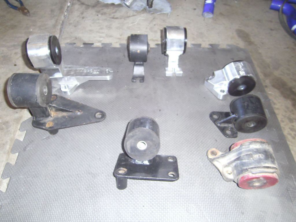

not alot on body work the last 2 weeks. other vehicles need to be worked on first. but ive been getting together other things i want for the car. found another shell for 250. got it for the straight doors and disc brake conversion. 92 integra rear and front and pro valve.. this kind of bled into another project, but thats ok.
ive always like this color.. theres a 4dr with this color too.
it had the 3 cheap rear strut bars too. purple rear lower cntrl arms/blackworks.. i laughed cause those prbly cost more than the car!
there was also mounts in the car aswell.. fukn score. theyre not hasports, but??. not sure what the extra mounts are though. you can tell the ef b-series next to the hasports, but there was 2 others, and 2 trans mounts too. [in the front]
any ideas on what these are?

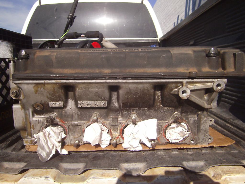

Postby acuda » Wed Dec 09, 2015 7:39 am
got a head from someone in town who "said" it was good?? took everything to the machine shop to find out the truth. **I DIDNT KNOW THIS. theres a stamp next to the head code that shows its been to a machine shop before. it looks like a washer. they fill that in with lead and if the head overheats that lead sags or runs down the head/block.. there was no lead on the head. which means it got above 295, even 300+ degrees. which also means shit starts bending and warping.. seperating... luckily i was prepaired for a valve job. im sure ill see that guy again. he had a blue super low ef wagon..
but now its all at the machine shop
