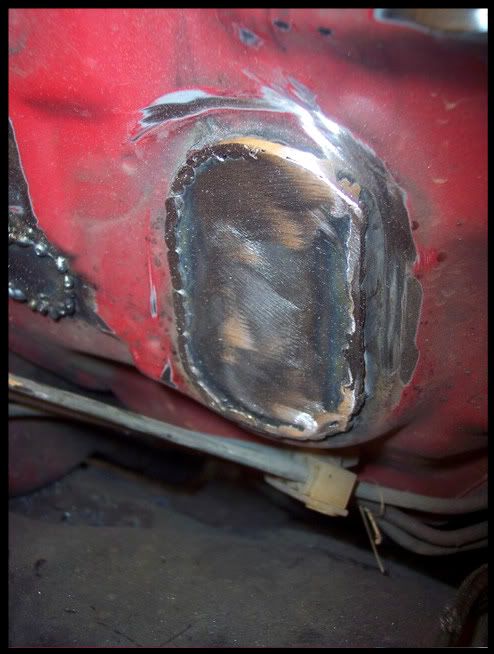

I also found that the driver side fender was molded to gather with Bondo. I don't think I have ever seen this much before lol I guess I'll be looking for a new fender now
Here's some of the work I got done. This part was really bugging me!!!

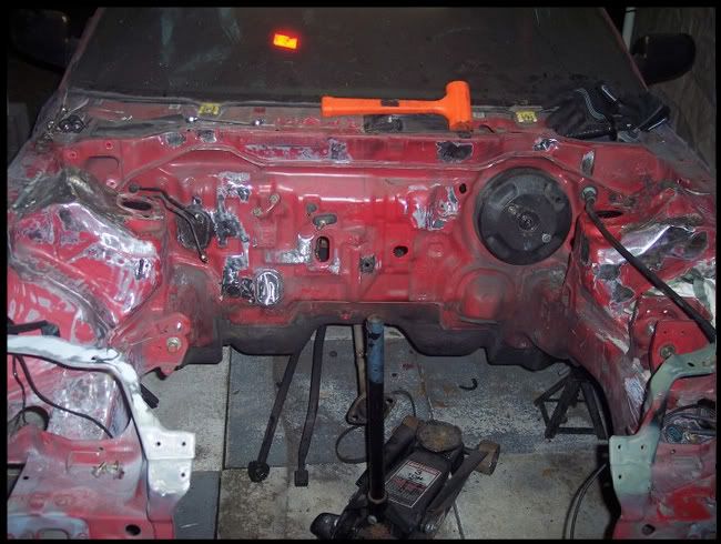

Started welding the bay. Got most of it done but started kinda late and didn't finish.

Welded up the seams, well some of them. I started looking at how the hell am I going to get a grinder in some spots so I seamed up what I could and will use a nice slim bead of seam sealer on the other parts.
A little filler
Man this is a lot of work.....maybe more then I want lol

Almost done, well with one side of the bay lol
All for now....I am so damn close!!!
