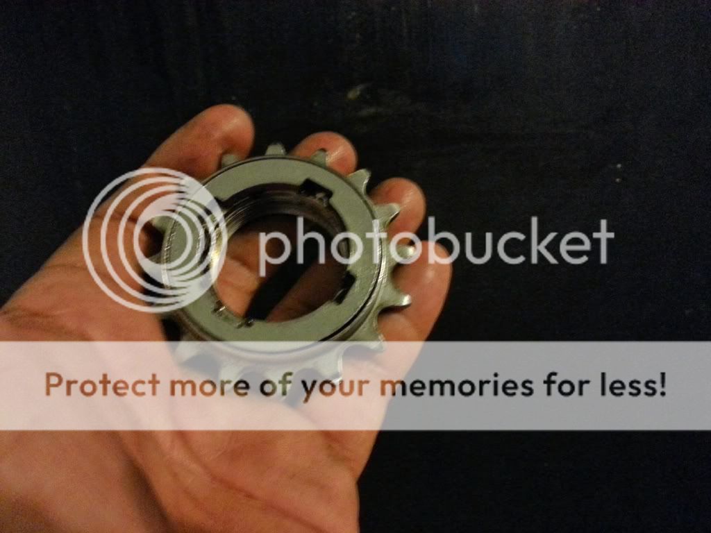

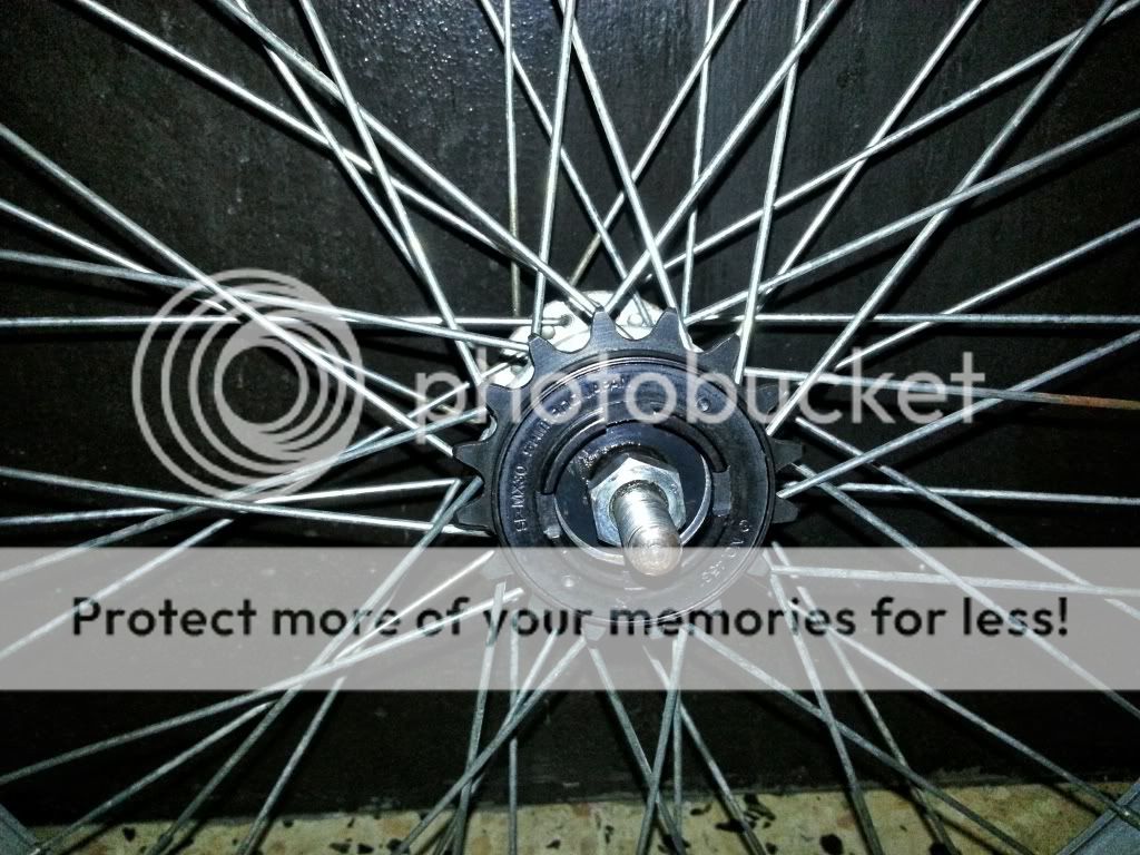

well, the dicta freewheel that came with the dyno crapped on me a couple times while pedaling, even after properly oiling it.
so i decided that it is time for it to go.
got a shimano mx-30 freewheel for cheap from a member here.
in order to do this, you need a bfw like this one here. of course it also helps if you have the freewheel removal tool (not pictured):
dicta freewheel off:
shimano freewheel on:
not a white industries fw, but this one will suffice until i get the money for said fw.

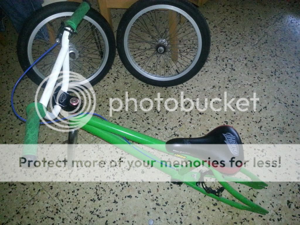

today's $40 score.
bought a powerlite blitz for $40.
spray bombed in a ugly green. handlebar is also spray bombed. in white.
frame looks sound. not bent, cracked and/or rewelded.
here are a couple pics.

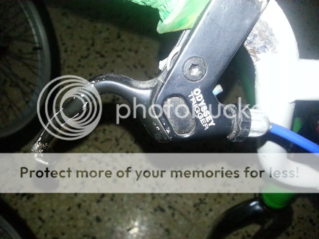

odyssey trigger brake lever:

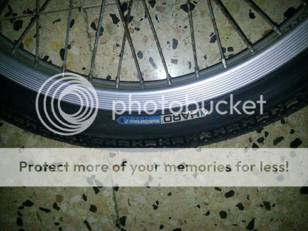

tires are 20x2.25 haro multisurface 2. both are in excellent condition:

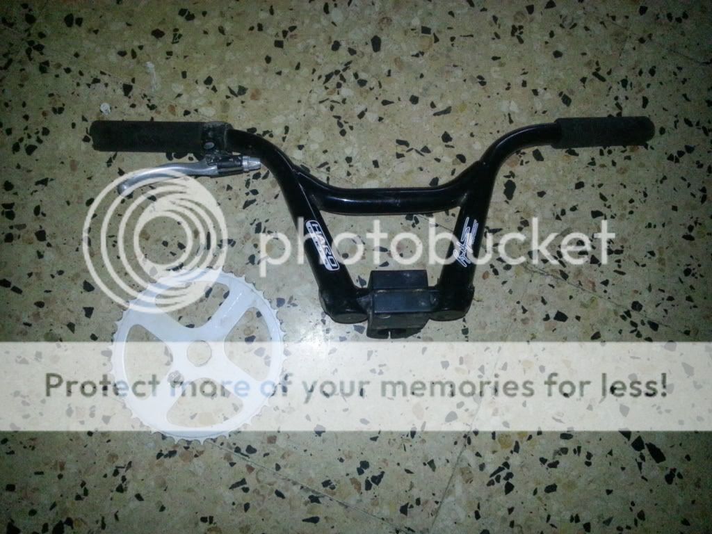

and also got this. a 44T spraybombed diamond back sprocket and a haro ryan nyquist pro model handlebar with a specialized stem:
also seat is a haro mirra pro series.

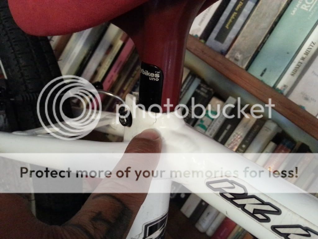

well... i got scammed on the pk ripper frame.
this morning while cleaning the bike i found this:
yup. is a crack on the seat tube, close to the welds. keep in mind that this is a aluminum frame. when i inspected the frame i noticed what seemed a small chip in the paint. i asked the seller if it was a chip in the paint he hesitated before responding and said yes, that was a chip in the paint. now i know why he hesitated before responding. i should've walked away.
so i took the frame to a machine shop that specializes in aluminum welding. after inspection, the owner of the shop said that the frame was fucked. here's why:
some asshole decided to dremel the inner diameter of the seat tube so he was able to cram the flybike seat and post combo. as you can see the seat tube now is paper thin. the crack can be welded but it still going to crack over and over again.
to fix this the seat post must have to be replaced in its entirety, so basically is making a new frame. cost is $150

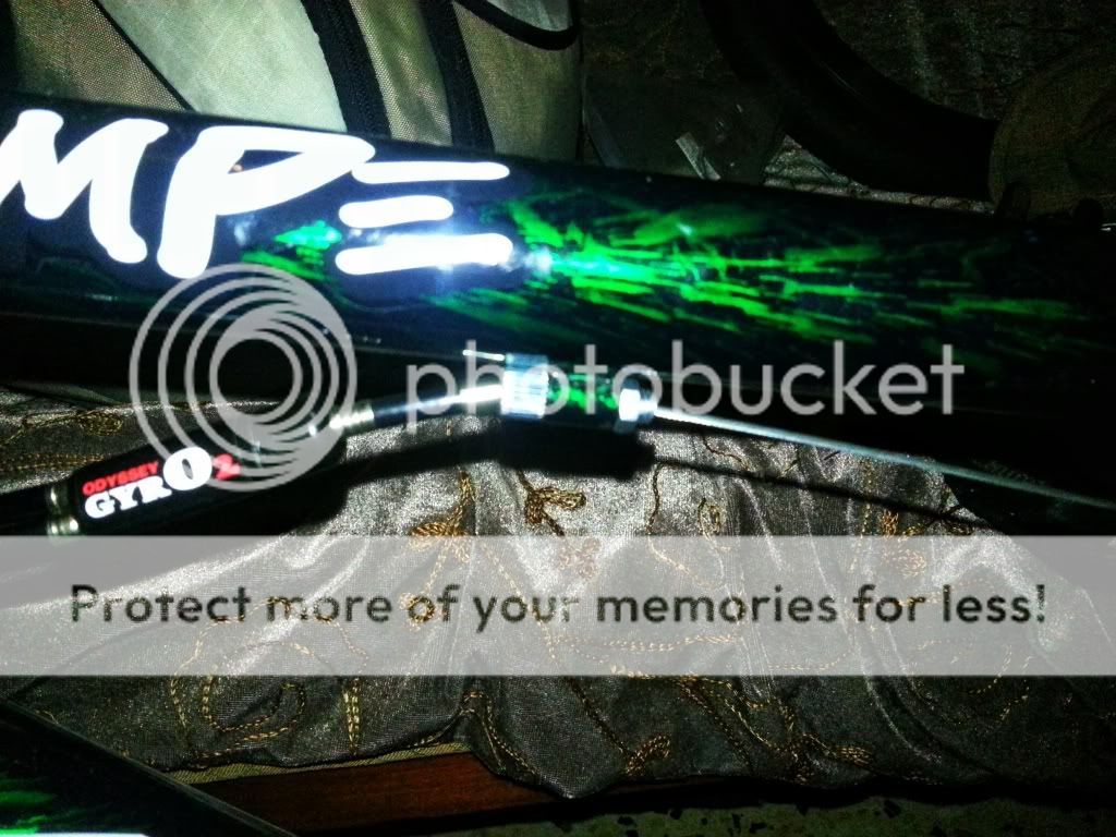

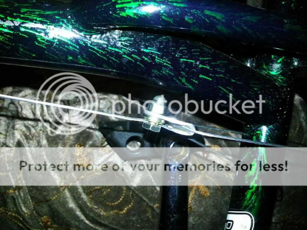

you will need the 990 brakes, the center pull thingie. also you will need a 990 brake conversion plate, a barrel adjuster out of any side pull brake caliper, and a cable guide on your bike. if you don't have that, you might have to drill onto the frame. ew.
excuse the quality on the pics, tomorrow i'll take better ones. let's start.
so. basically the cable guide on your bike is needed to convert the barrel adjuster into a cable stop. what i did was to measure how much cable cover i needed, and cut (the cover, not the cable):
install the 990 arms into the brake conversion plate and install all that in the frame. i chose to do it upside down for cleanliness.

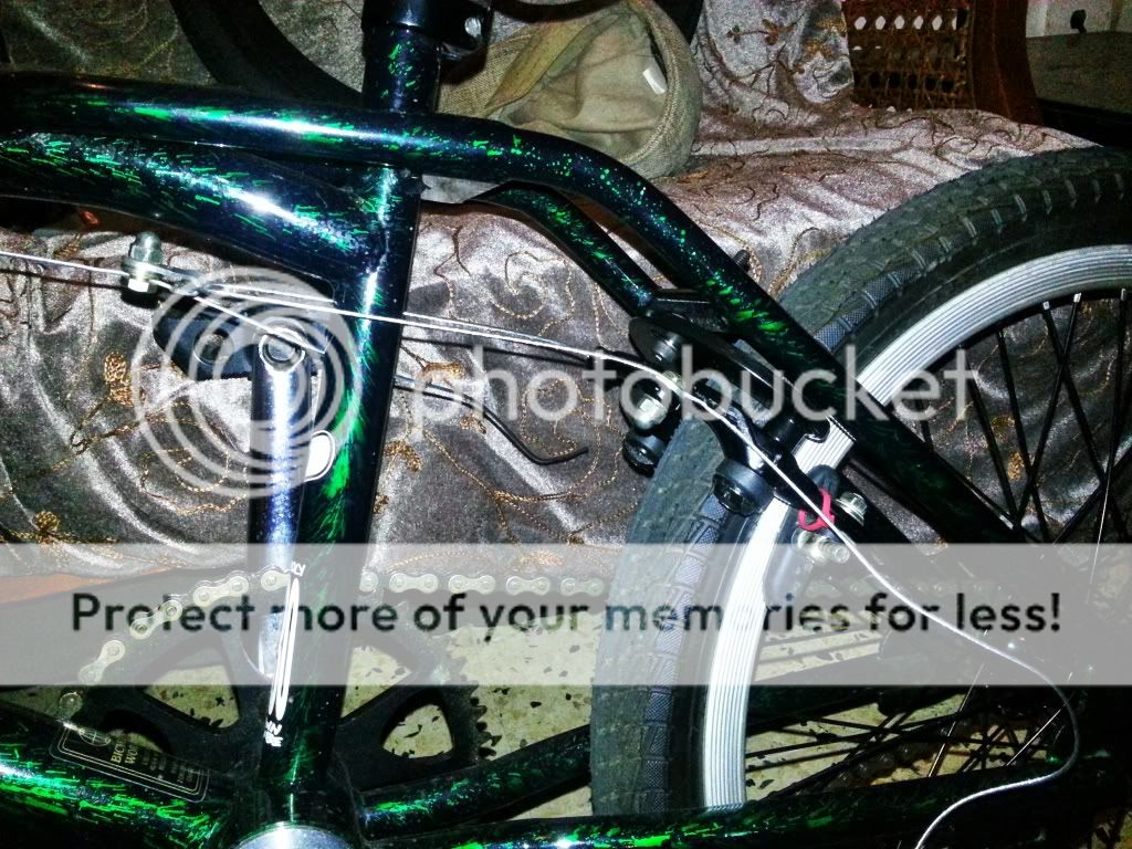

the rest is easy. you need to measure both the cabkes lenght for the center pull thingie. t would be ideal if the caliper arms cable were located behind the seat post tube, but then i would have to drill both the seat post tube and the seat post and that would have complicated stuff uneccessarily. so this would be the ideal location:
here it looks better. again i excuse myself for the quality on the pics:
and that's how you convert to 990 brakes in a dyno compe.
