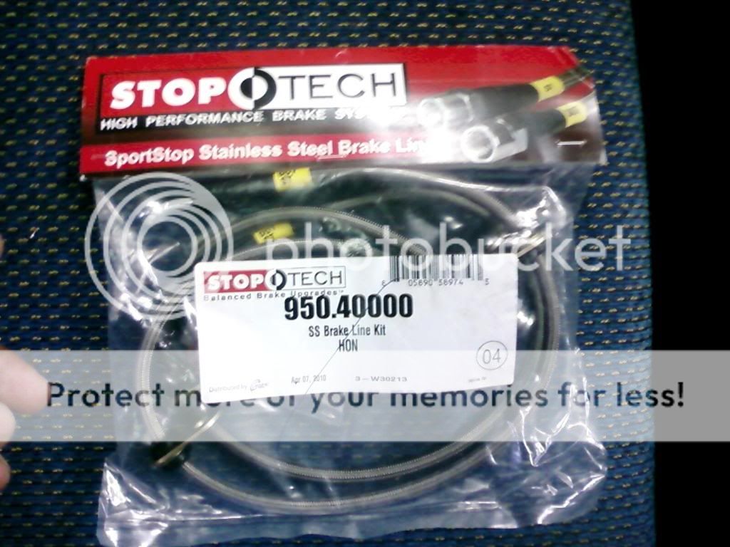

lookee! just got this box from fjdistributors like, 10 mins ago.
oh! ah! a set of stoptech ss braided front brake lines!
and set of energy suspension rear trailing arm bushings for me ED! the oem were beyond shot!

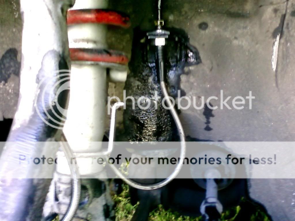

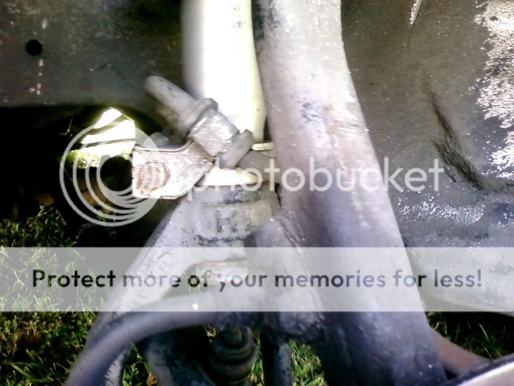

update!
well, ss braided front brake lines and energy suspension rta bushings are finally in.
pics to follow. enjoy.
old setup (driver side)
new minty ss brake line (driver side)
old setup (passenger side)
new minty ss brake line (passenger side)

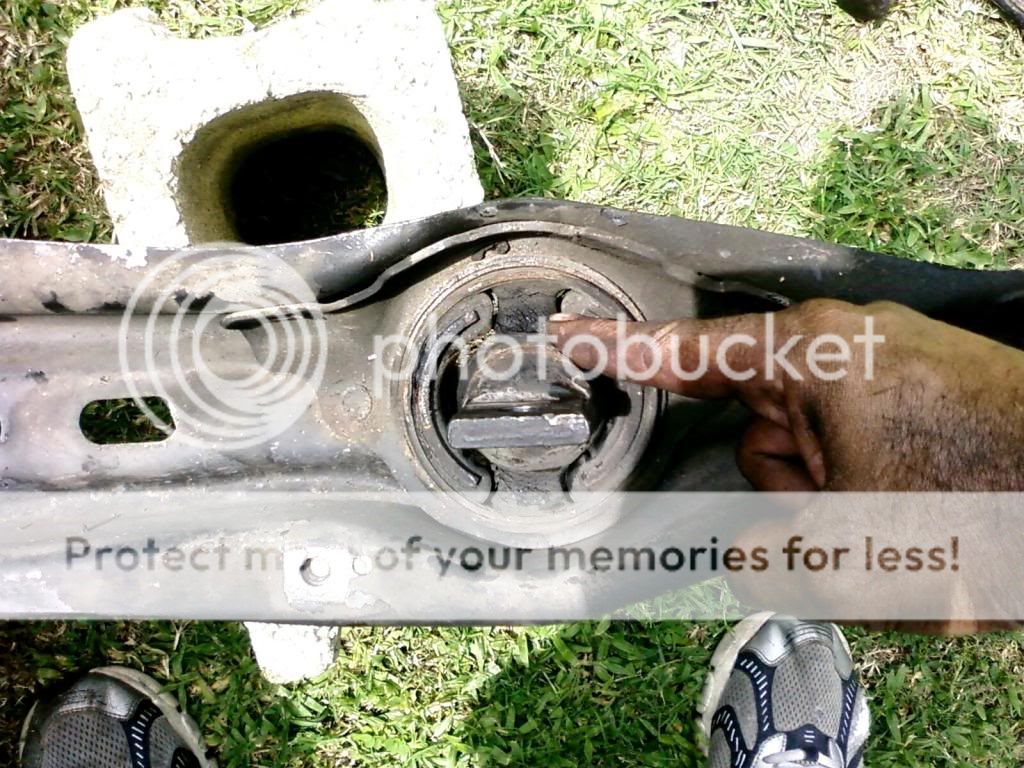

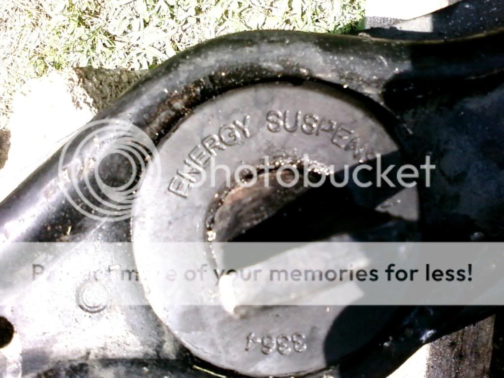

and now for the es rta bushings. pics are from the driver side only.
old effed-up rta bushing (driver side)

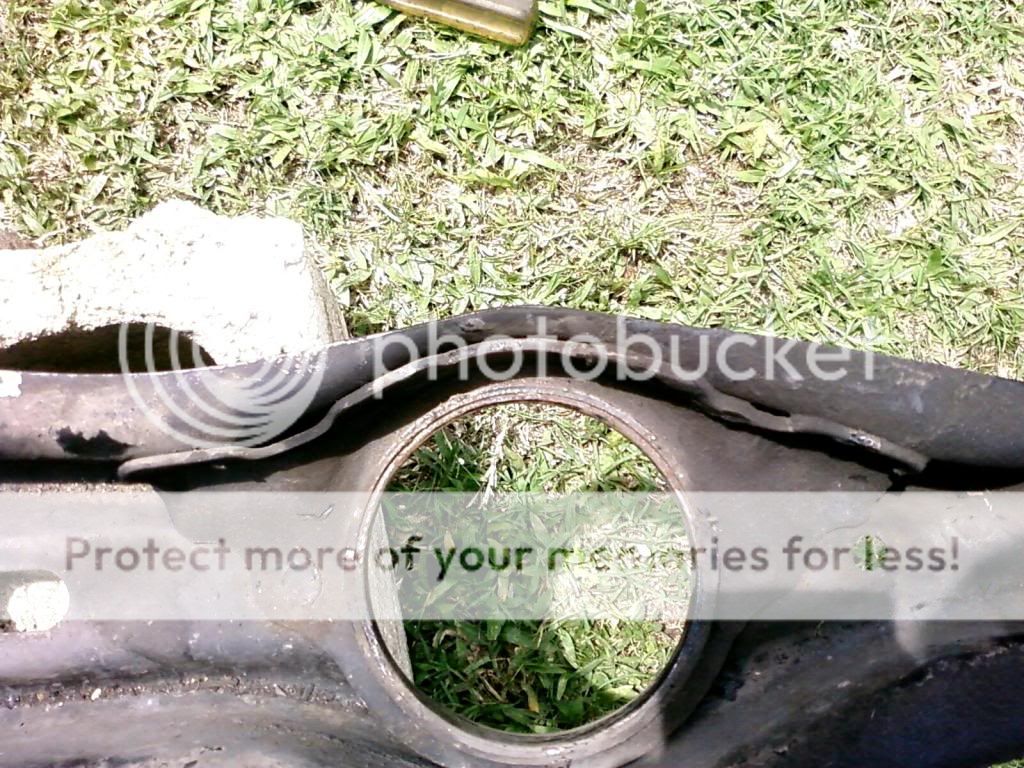

old bushing go-gone

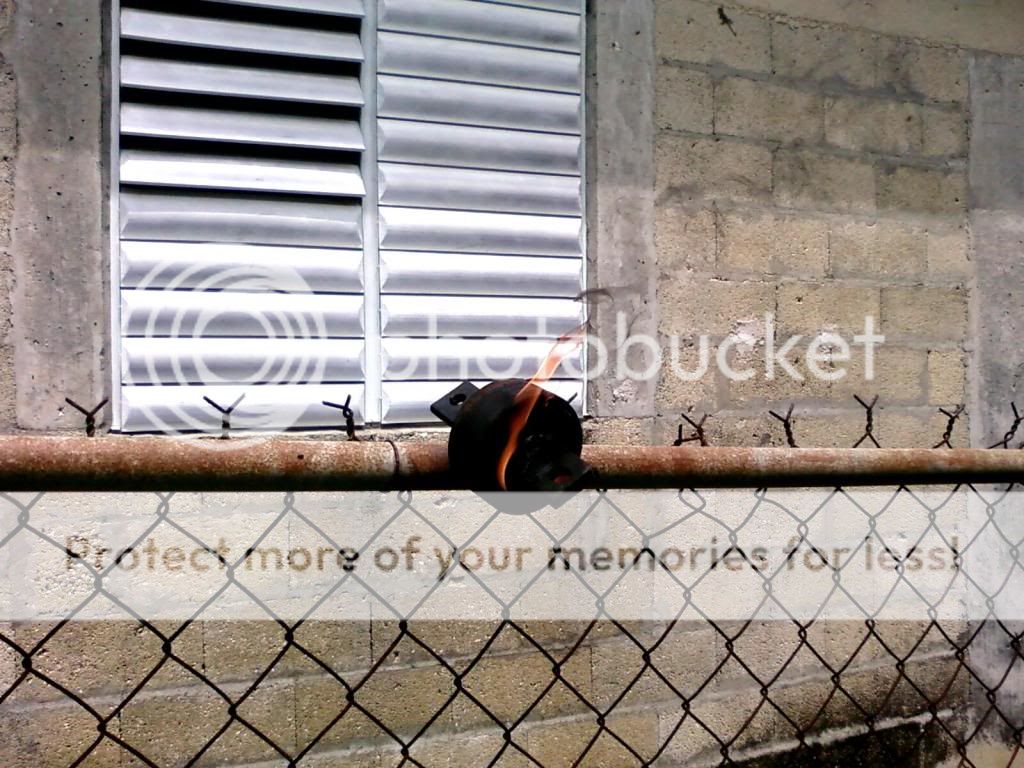

burn, baby burn
there.

I bet those bushings are a real pain in the ass to take out...
IHeartMySTD wrote: We all know we like our women and cars with D's, not B's!!!!
el_jelly - L6 - Race Bred
- Posts: 7734
- Joined: Mon Dec 09, 2002 3:27 am
- Location: Puerto Rico
Re: well... deddth has entered the building... lol.
getting them out is the easy part... getting them in, especially if they're es bushings, well that's anoher story.
to get them out of the rta, get a 2.5 lb or so hammer and hammer them out, just a couple blows actually. before you do anything make sure you clocked the position for the new bushing to go in, that's for he oem one. since mine is solid i felt no need to do so.
with the es bushings you have the reuse the oem bushing collar. you can either cut the rubber out of it or if you love to set things on fire (lol firefirefirefire!) a propane torch will do the trick.
make sure there's no rubber leftover on the collar and the bone. lube the bushing, and with help from another slip the bushing on the collar (not an easy feat). slip the bone. then hammer it back to the trailing arm and voilà, it's done.

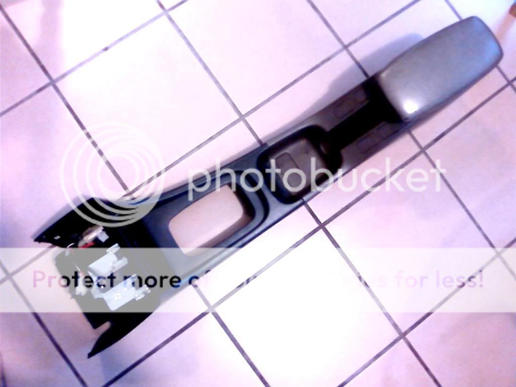

well i got this for the hatch:
yep, a dc integra center console with armrest. first half i gor it locally, the armrest part i got it from my buddy myhonda1 from d-series.org . the cig/ashtray part i got it from him as well.
price? dirt cheap, son.
the only thing is painting the armrest part from tan to black, but that's easy as cake.
will do that soon. first i gotta get the engine swap/manual conversion rolling.
