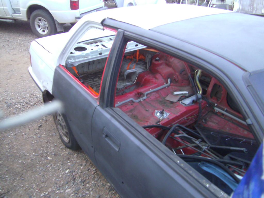

Postby acuda » Thu Nov 12, 2015 4:06 pm
ready for test fitting.. one of many

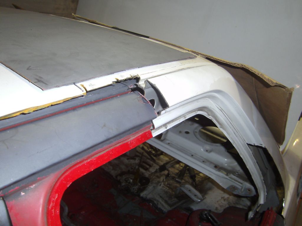

Postby acuda » Thu Nov 12, 2015 4:13 pm
big deal: so the hatch back tapers in and down...the 4door stays straight and pretty level.. giving you about a 1/2" or so gap taller on the top and on the sides.. roof line, drip line, window seal, body line.. all of them have to meet up... right?

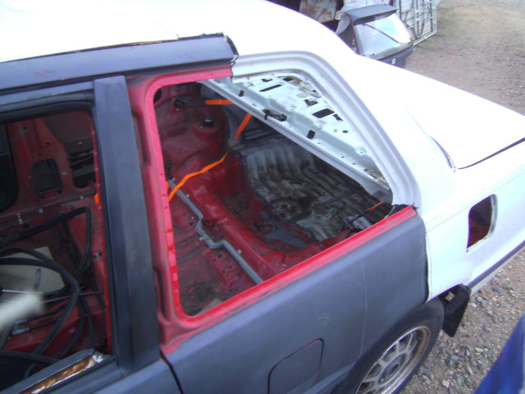

Postby acuda » Thu Nov 12, 2015 4:31 pm
window: i meassured alot of windows, but "wanted" to stay with honda parts.. the best and most compatible was the 90'-93' accord coupe quarter window.. i was going to use the widow jam from the accord too, but measurements didnt let that happen.. so we have to build the back half of the window jam..YAY!!

Postby acuda » Fri Nov 13, 2015 6:02 pm
trunk floor connect

Postby acuda » Fri Nov 13, 2015 6:27 pm
chop and section the back window
