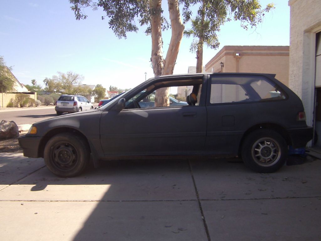

The 4 door 4th generation civic has always been my favorite. A friend had one when I was younger that made me always like them. I also liked how small and lightweight they are. Even with the interior complete. I've had a few of them in the past, but never had the pleasure of finishing the builds.
The hatchbacks are even lighter, and are perfect for sound systems. I've never owned one because I thought they were a bit too small... I personally like 4 doors, and having a trunk.
Since I first got into the scene I thought it was weird that honda never made a ef coupe. I always thought about how cool it would look, and how you could pull it off.
That was along time ago. I've had a urge to do this surgical procedure for quite a long time. It was always in the back of my mind, because everytime i see a 4dr or hatch... I see the coupe in my day dream. I believe this picture is cgi, but tha'ts my opinion, because there would be pictures everywhere of this car.. idk, Maybe that's just me. It serves as a good reference to get an idea of what the finished product will look like...

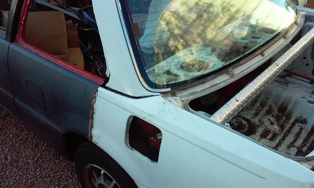

big deal: so the hatch back tapers in and down...the 4door stays straight and pretty level.. giving you about a 1/2" or so gap taller on the top and on the sides.. roof line, drip line, window seal, body line.. all of them have to meet up... right?
Re: EF COUPE
Posted: Thu Nov 12, 2015 4:31 pm
by acuda
window: i meassured alot of windows, but "wanted" to stay with honda parts.. the best and most compatible was the 90'-93' accord coupe quarter window.. i was going to use the widow jam from the accord too, but measurements didnt let that happen.. so we have to build the back half of the window jam..YAY!!

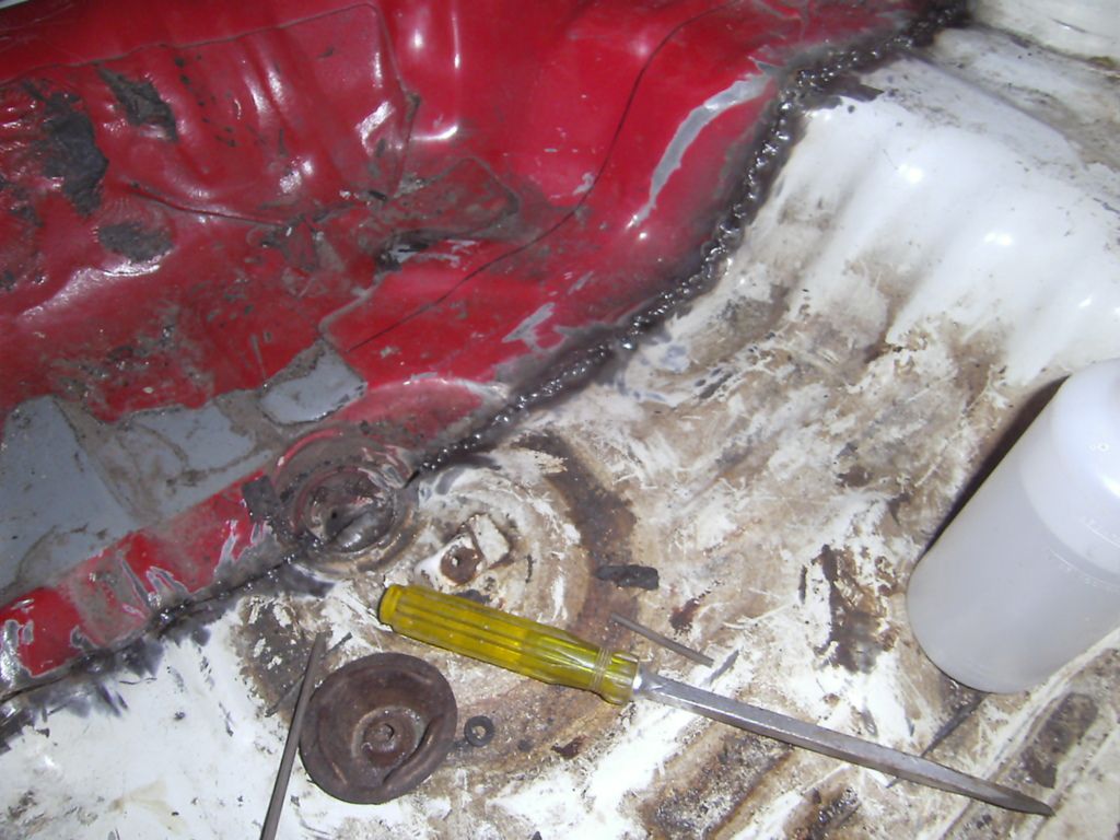

trunk floor connect
