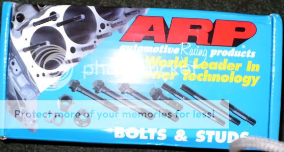

Well the engine is coming along nicely, should be done by August.
The block after a .020in bore and .010in deck. Got some accessories put on. All gaskets, O-Rings, seals...brand new. Everything down to the little O ring on the oil jet.
Nippon pm3 pistons and ACL Bearings
ARP Rod Bolts
ARP Head Studs
That's it for now, Bisimoto valve springs and Delta 260 regrind are on their way.
