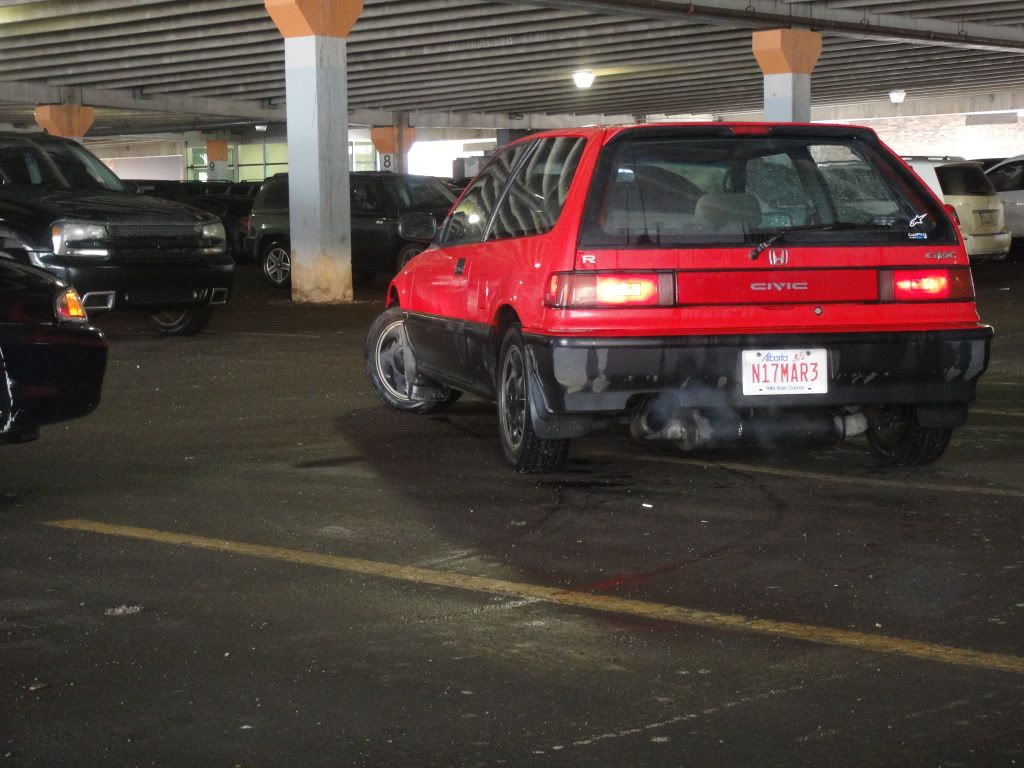

okay, so im planning to do an engine swap on my civic in the spring time as my current D16,has had a hard life, and is leaking oil like a sieve. my current setup is Turbo with a minimal supporting build, running ~8-11PSI. and i like the the idea of turbo. what i want to know is should i just buy another D16, and build it up again, and swap that into my car, or go big, and build a B18B? what would advantages and disadvantages be? this would be my first swap, but i'm not completely ignorant as to the details and such. any help, or suggestions would be a great! i have hopes of making this car a head turner when all is said and done. ;D
just because i'm new, heres what my baby looks like as of now.
